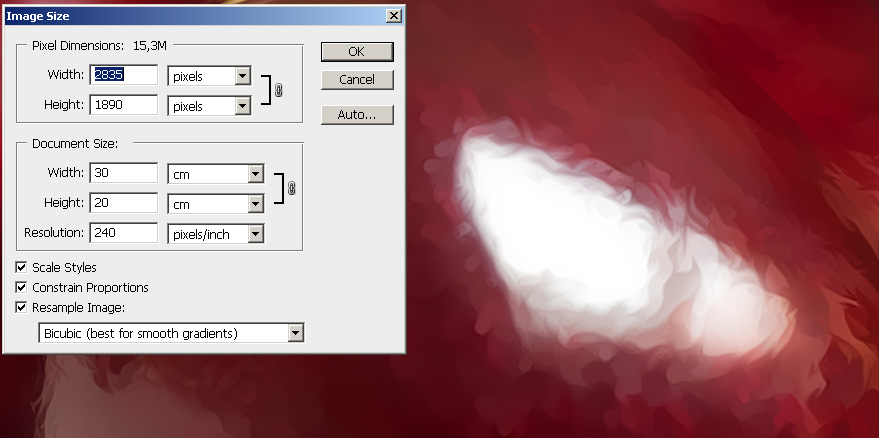

My question here is, I like much better the effect topaz makes in my pictures when they are 300px resolution, but I want to print them larger. What is going to happen when I want this picture printed let's say in a 30 x 20cms size?
Here is the same picture I posted with 300px resolution, back to 240px.
[Image: resized.jpg]
What would it be the best to do? Should I re size my picture to 300px resolution before my treatment and crop? I am a bit confused ....
Thanks for your help... Smile

I haven't used Topaz, but as a general rule I'd suggest keeping images in their highest resolution (not resampling at all) for as long as possible throughout your processing. I try to limit resampling to something that only gets done once as the final output stage. Every time you resample, errors are introduced and detail is lost or softened slightly. Products like Genuine Fractals are excellent, but they aren't magic.
However, I notice you were talking about resolution in terms of DPI rather than pixel dimensions. You do realise that you can change the DPI of your image without changing its pixel dimensions, resampling or causing any change in quality, right? In the "Image Size" Screen as shown in your post above, simply unclick the "Resample Image" check box and then change your DPI settings.
Depending on how the Topaz filter was written, it may examine either image dimensions or DPI, so changing the DPI without resampling may or may not have any effect on it's output. Try it and see.
Yes, I have tried and I like it!! Smile
I did it as you recommended and I get my picture with 300 Res. and the same number of pixels . The size now is 36,98x24.xx cm.... Smile I understand that would be my print size in a good resolution.
Thanks so much Adrian for your comment and advice. It really work great. Topaz worked perfect too, very fast and the effect was really good... I am very happy! Smile
