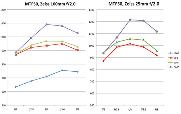

Here is some testing Roger Cicala of LensRentals has done:
http://www.lensrentals.com/blog/2012/03/...tion-tests
There's a lot of good detail and graphs in the article, but this one speaks for itself:
attachment=219]
He does quantify this though by saying that you absolutely need the best lenses to take full advantage of that sensor.
Ok, time for us Canon fanboys to go cry in a corner...
That's a very interesting graph.
I'm looking more at the differences within the brands instead of across them. The two latest 5D variants are essentially the same pixel count, so I'm surprised to see the MkIII pulling ahead the way it does. The results between the two Nikon cameras are perhaps more expected, but it's still amazing to see the difference in the resolving power between the very different pixel counts.
It looks like the real competitor to the D800 for very high resolution is going to be the D800E. Canon and Nikon have built very different styles of camera once again, ensuring that there will be plenty of discussion for a couple more years.
It's interesting how hard they had to fight to stop from saying that the D800 was the better camera… Jules, you should really get one.
I think that there might be some interesting material once they reach the video comparison, since that's such a new area (especially for Nikon) that there could be some significant differences between the results. But from what they said in the stuio photography comparison, and from what I'm seeing elsewhere, there really isn't much cause to choose one over the other. Essentially, if the results from either near-top camera from the two best camera makers in history aren't good enough, then it's probably not the camera that needs to improve.
