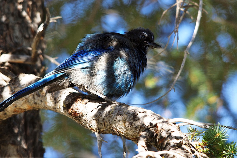

I am not sure how to correct these pictures. I shot them with my Sony a65. The Stellar Jay was shot at ISO100; f/6.3; 1/80. The background is so blurred that I did not manage to get a good shot of the bird. Most pictures I take are of wildlife using my Sigma 150/500 mm lens. Also, should I leave the AF illuminator off or on when taking close up pictures of birds/wildlife. Can you please help?
Apart from the composition (the bird rather high in the frame and its tail clipped off), I think the main problem here is the lighting - the top half of the dark bird is in dark shadow set against a dark background, and the natural light was beyond your control.
In post-processing you might try to bring the bird out of the darkness, by increasing the brightness of the background and decreasing its contrast, together with increasing the contrast of the bird and foreground, and some sharpening of the bird, e.g.
[attachment=3708]

The background will be blurred when using a long focal length lens at wide aperture - both parameters reduce the depth of field.
Consider using a higher ISO, e.g. 400 - your Sony should still produce clean images - but you can then use a faster shutter speed, which reduces the chances of motion blur softening the image.
The focus assist lamp is unnecessary in daylight outside, and it might spook a timid creature.

A quick 5mts. in Photoshop. Away to watch the Football!! Ed.
Football finished, another 5mts. Just a shot that did not make it fully, think the bird's head moved, to boot. As Philip says, higher ISO would have helped a bit. Chalk this one up to experience. Cheers. Ed.
