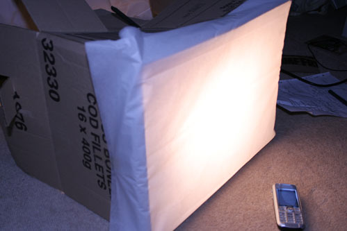

I made a soft box out of some tissue paper, a card board box and stuffed it with a 500k halogen workman's light. It softens the light, but not the subject.
[Image: softbox.jpg]
I find that, although my subject isnt real, the overall image comes out too harsh, or not soft enough.

Don't fret my Friend. You chose a good camera and I'm sure you'll get the hang of it. One thing to look at is the cameras white balance settings. I prefer to keep mine on Auto. That would be a good place to start for you too until you get the hang of the rest of the settings. From the first shot you show it seems fine. The 2nd shot suggest that it is a tad bit under exposed. As you said, the softbox softens the light and not the subject. That is what it is supposed to do. Softening the subject is not a light issue if you are indeed talking about a "soft focus". Then you do in fact have to edit in photoshop unless you want to use filters on your lens for the effect. I can assure you that any images you have seen on the CD you mention have had a certain amount of post processing.

Drunkentre Wrote:I made a soft box out of some tissue paper, a card board box and stuffed it with a 500k halogen workman's light. It softens the light, but not the subject.
I'll think some more about your camera issue, but let me first warn you that you are going to burn down your house using tissue paper and a 500k halogen lamp!!! Those lights get HOT HOT HOT!!! Be careful! And don't use that light around pets or children!!!

Dont worry, i use these lights for filming. They get quite hot very fast, so all safety methods are praticed & such, although burning my house down may create a good picture.
