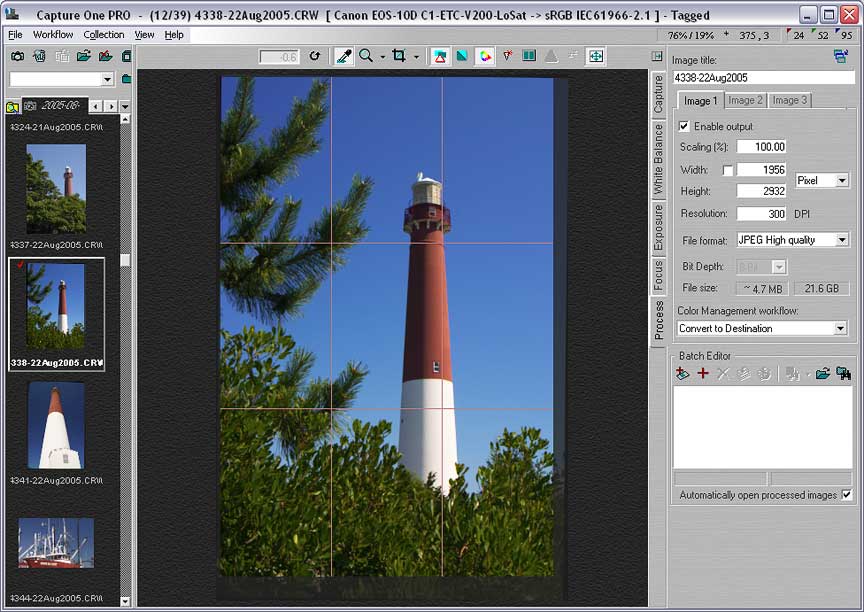

Highlight the preview thumbnails for the ones you want to process, then type the "insert" key on your keyboard.
BUT FIRST ...
Go to the "process" tab and set all the settings, and also the directory where you want the processed images to go. Then click the button to start processing. (Or the insert key, which is just a keyboard shortcut.)
Hang on and I'll try to post some screen grabs ...

byrt_001 Wrote:what i have found out is that after goin to process opens the pix in photoshop as tiff.
Yes, you can turn that off if you want: click the little checkbox at the lower right that says "automatically open processed images."
To set your directory folder for the processed files, click the green folder under "batch editor" and set it there. The easiest thing to do, once that window opens, is click the box that says "always process to associated folder." Then it will create a "developed" subfolder for the folder that has your RAW images. It's a convenient way to keep organized.
Also notice the three tabs "Image 1", "Image 2," and "Image 3." You can process up to 3 different versions (different file sizes) of the same image at the same time. So you can make a full-rez file, a low-rez for emailing or web posting, etc.
And when you are ready to process them, click the red
+ under "batch editor" and it will queue up your files. (Note: use the leftmost red
+ to actually process them; the other one adds them to the queue but doesn't start processing.)
