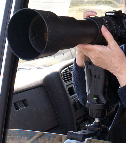

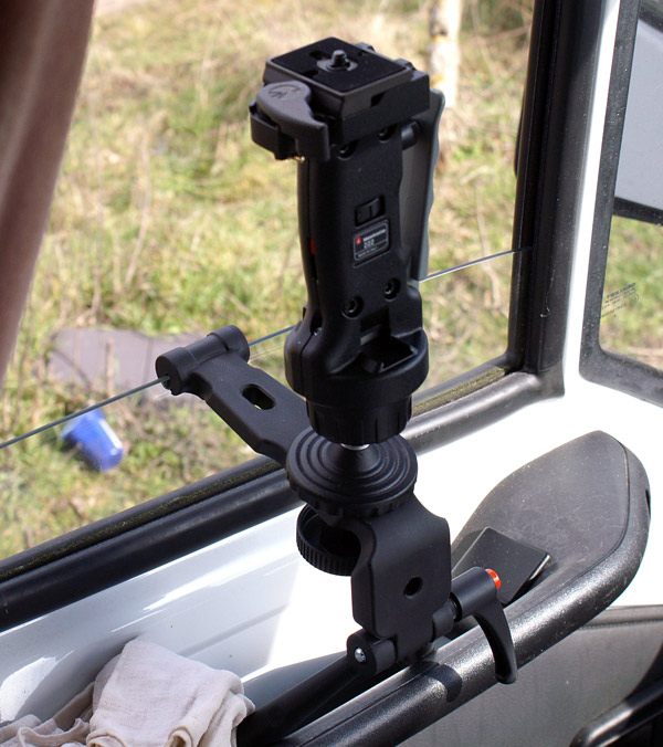

I'm not quite sure what you mean?? D'ya mean you were looking for details of the multitripod and ballhead setup I use when using the long lens from the side of the campervan (setup on the passenger side opened window).
If so - I use the 'ErgoRest' multi-tripod with a Manfrotto 222 Grip Action Ball Head. Best offer I know of atm for the Ergorest is about £42 from 7dayshop. Dunno the current price of the 222 Ball head but they're widely available. The Ergorest and 222 tripod head is also reviewed by Andy Rouse on the Warehouse Express site.

..... and a couple of snapshots of the Ergorest + 222 Ballhead set up on the window of the camper. One from the inside, one from the outside ( with the Sigma 170-500 attached)

Wow, that's a pretty cool setup Pol! Big Grin

shuttertalk Wrote:Wow, that's a pretty cool setup Pol! Big Grin
It's very useful when parked up, especially in the campervan as it's set up quite a bit higher than a tripod - so I can see over hedges etc and further into the distance.
It's not suitable for when the vehicle is moving though, because it's not actually *clamped* to the door/window. It's firm enough for general support but you'd need the proper clamping system for 'on the move' shots.
