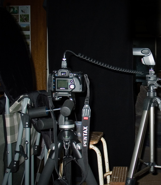

I imagine everyone has their own specific method for this kind of smoke shot but here are a couple of shots showing how I did the ones I've posted here. I'd also be interested to know how Shawn went about getting his own shots.
I used a Joss Stick for the smoke - set the joss stick on an old kitchen stool about midway between the camera and the background. Background was a length of black velvet.
Camera on a tripod with cable release.
Off-camera flash set up to one side, black reflectors opposite side .... ideally the light source should be from one side only so the velvet and black reflectors stop any stray light from bouncing back off the flash.
Small aperture to aim for a fairly good depth of field between the smoke and the background - that helps to capture clean, crisp lines of smoke.
Pre-focussed by using the flame from the Joss stick (the room was comletely dark as I was using only the flashgun for lighting) .... then I simply kept firing and capturing smoke swirls and chose the ones i wanted for post processing.
For post processing - invert the image and that makes the black background turn white. Then use the channel mixer, or any method you prefer, to colour the smoke.
Two shots attached - one showing a copy of the pre-focussing test shot, second one is a rather messy snapshot of the entire set-up. Images resized to fit completely into the forum interface (I hope).
I hope you can make sense of all that.
