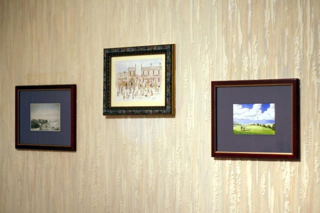

I have bought matte or art board at an art shop. I don't need great quantities, so I get off cuts. It comes in many colours and shades. I mark with pencil on the rear and cut with a stanley knife.
For one offs it is ideal, just the corners that need a little care.
I have also printed A4 sheets with a single colour/shade that I required and cut out for the photo, and laid that over the matte. A tiny bit of double sided tape will hold it in place.
The ones at either side (grey matte) are the ones I have framed with charity shop frames My printer was on the blink so they are a tiny bit striped, but this will be rectified when I re-frame them.
![[Image: 54_IMG_5090.jpg]](http://www.shuttertalk.com/forums/images/upload/54_IMG_5090.jpg)
