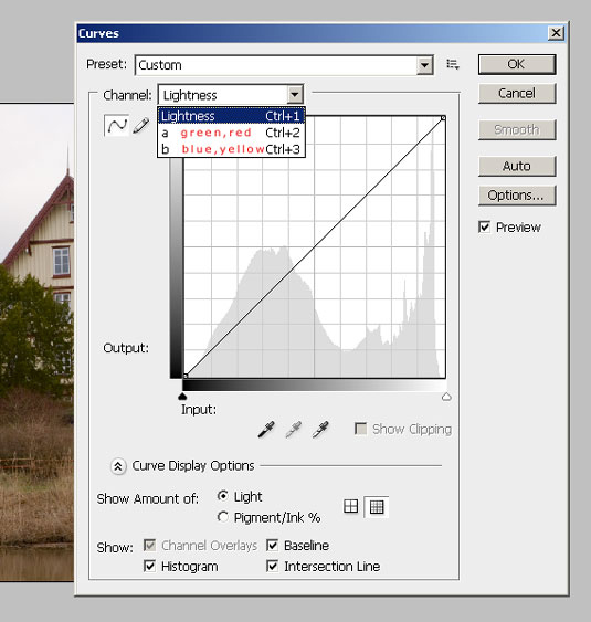

So, open curves in an adjustment layer, in the menu you will have lightness, a and b.
- b will work the blue in the lower left part of the diag. and yellow in the upper right part.
- a will work green in the lower left part of the diag. and red in the upper right part.
- Lightness to work contrast.
![[Image: 48_Untitled-2.jpg]](http://www.shuttertalk.com/forums/images/upload/48_Untitled-2.jpg)
So we work first with blue and yellow.
In the curves menue click b, and shift the left dot to the right, and the right dot to the left in the same
proportion as we want to work in the whole image.
Do the same with a (green and red).
Work lightness at the end so leave it for now.

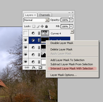

Now you have a selection of the sky, you may apply some other adjustments like saturation, leves or again curves but this time working with lightness.
To call the sellection to work again with another adjestment layer go to the layers palette, right click in the mask
that has the selection you want to call again. Click in the option Intersect layer Mask with Selection. You will have
the selection ready to work again.

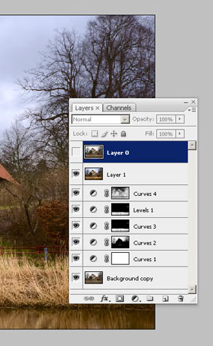

As I worked with the sky I did with the dry grass near the lake. I enhanced the yellow and with the selection I
applyed levels.

Here is the image with all layers I worked in this image before merging.

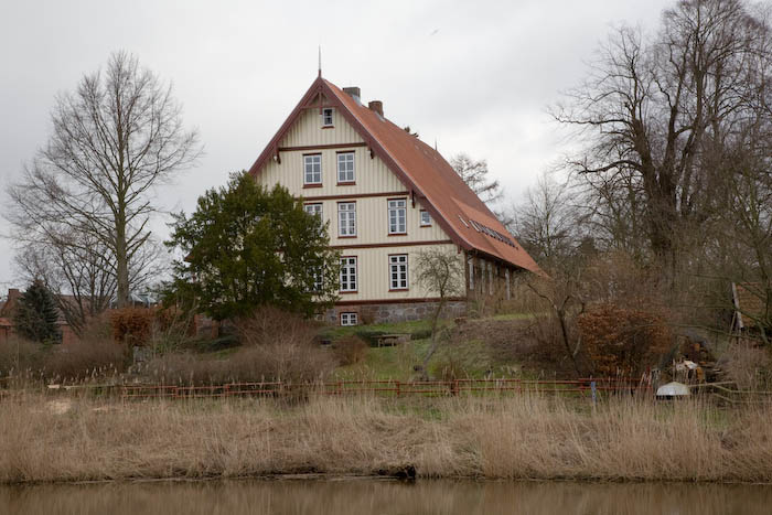

So here is the before and after...
![[Image: IMG_6903.jpg]](http://www.shuttertalk.com/forums/images/upload/IMG_6903.jpg)
![[Image: IMG_6903-Edit.jpg]](http://www.shuttertalk.com/forums/images/upload/IMG_6903-Edit.jpg)
